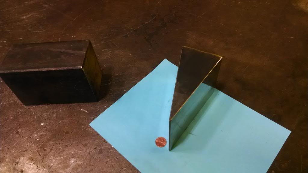

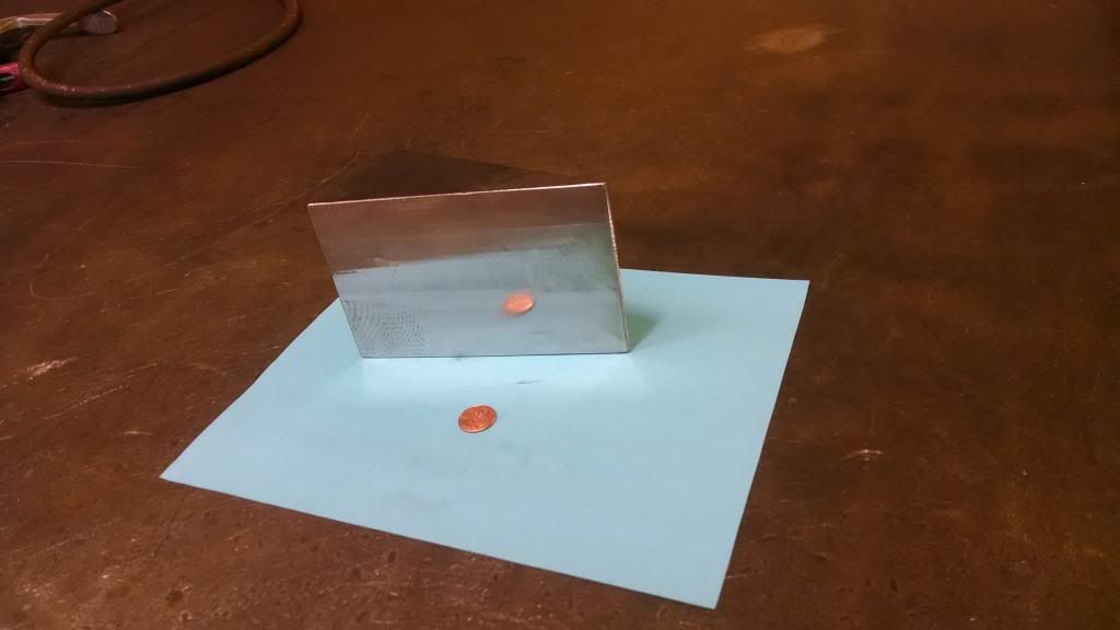

Here are a few pictures. Did not have a piece of pipe handy for the handle. I have some 1 7/8" O.D. but it feels to big, I am thinking 1.5" for the handle. I ended up making this out of a piece of 4340 from a large piece of fork (from a new front end loader fork). It is some hard stuff so it should work great for the maul. It ended up being 2.9" wide and 4" thick. From the point at a right angle to the back is 6".
[Hearth.com] Monster Maul dimensions.
The piece to the left is the other half of the chunk of steel I made this from.

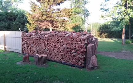

Looks like it should work great! For all the naysayers this 4 cords, and all the wood from nearly 40 years of burning , was split by a worthless monster maul.
Are there better mauls out there? Probably, but the old monster will get the job done.
