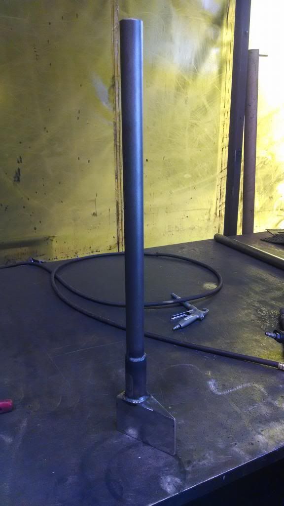

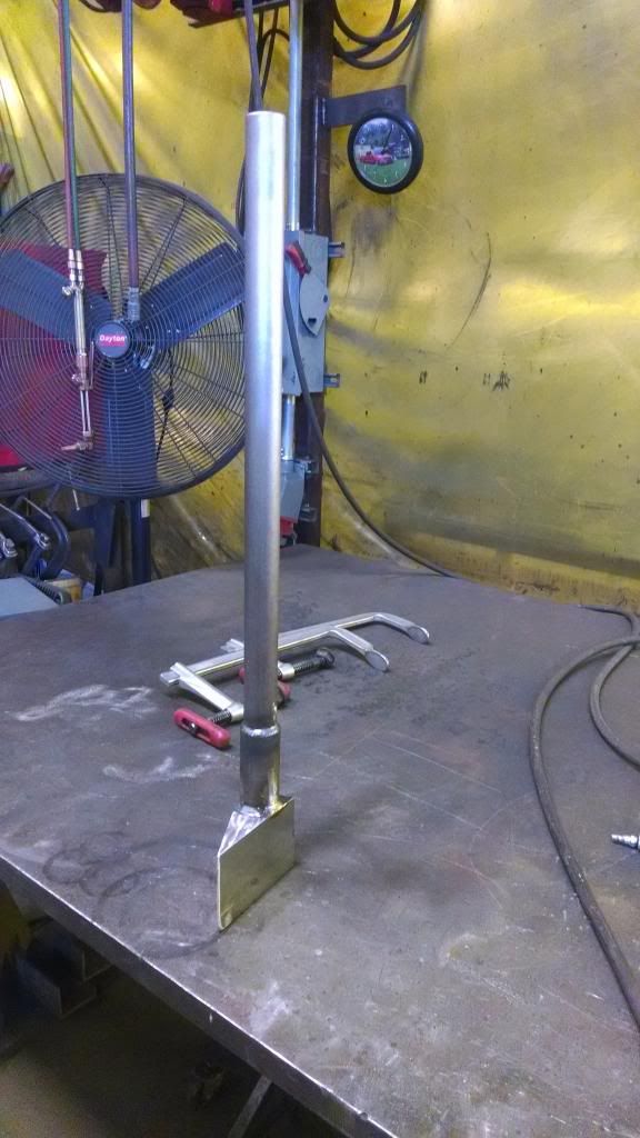

I have looked at the x27 and I would like to own one, and I hear great reviews from everyone. I do appreciate the physics behind it and less work = more fun, but less money = less fun too. Its raining out side or I would have given it a test run. Found a handle today and finished it up, still needs a coat of paint. Seems to be a good weight. Best of all I can say I made it and it cost me nothing.

Suggestion: Round the back corners off. If for some reason you get that thing stuck half way into a log they may try to dig in and prevent you from getting it back out. It wouldn't take much, you just wont want them to be sharp corners.
That is a great suggestion. I will be sure to do that thank you.

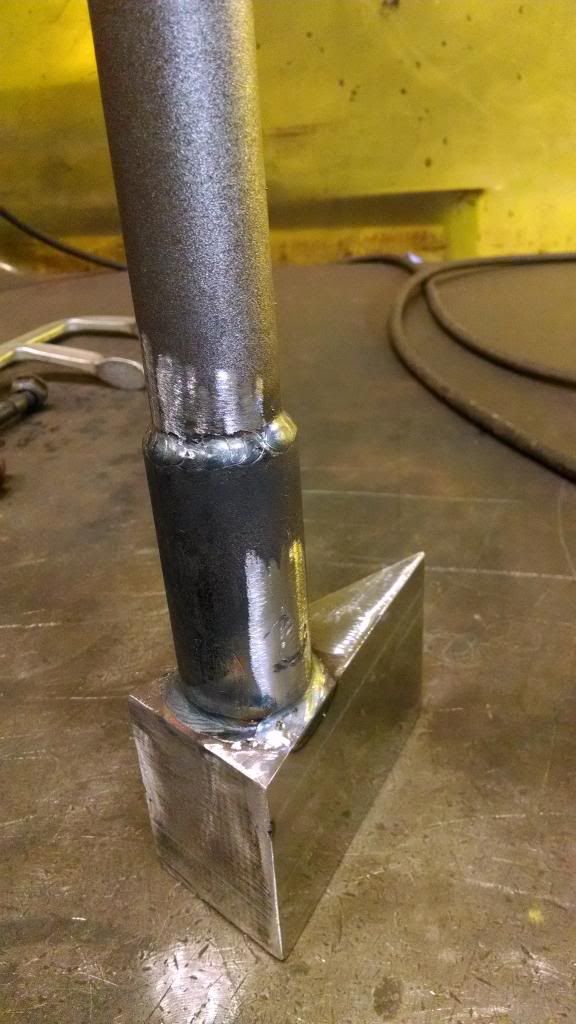

So, what are the dimensions of the "Proto 1?" :cool: Head, handle length, weight etc. If the pipe is the same size as the original (looks to be 1-3/8",) then your head is definitely narrower. Obviously the original pipe isn't as thick as Sch. 40 or it wouldn't have broken like that. Sch. 40 was probably too heavy to get enough speed with? Different head dimensions or handle materials would yield different results. Maybe you can come out with a complete line of "Protos." Titanium handles? ==c
Quite the collection you have there, my handle is down inside the larger sleeve near the head and "plug welded" in two places to hopefully keep it from breaking like yours did I also put quite a chamfer on the outer sleeve to allow the weld to penetrate into the smaller piece inside.
Dimensions are 2.8" x 3.85" on the back of the head
6" on the face
Handle is 1.56" dia x .125" wall
Length is 30" including the 4" long 1.9" dia sleeve
Overall tool length is 33.85
And weight is 14lb 6oz
