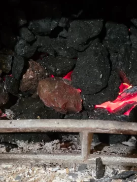

I have a Morso Squirrel 1410 its the coal/wood version. I have a issue buring coal. Mind you I'm new to hand fired coal stoves. Any advice would be appreciated.
So issue is my coal is turning a red color and then wont burn. This seems to happen a lot. I included a picture.

I have the correct coal type, and size. Also, this stove has all the correct parts to be the coal version. So apparently this stove isnt the B version. It has both the top and bottom air inlets, Shaker grate, the thick smoke baffel.
I think part of my issue is im missing the coal savers. Well I do own them they are warped beyond usability. Idk, Im new to hand fired coal.

I would think they're part of the coal burning system and should be used.
I looked around the Coal inserts/fuel economizers part number 62905100
Only places I can find online that sell the parts are in the UK. But your local Morso dealer should be able to help you out. https://morsoe.com/us/where-to-buy?category=Indoor
Thanks for your input. I had a fire last night and it went well. Fire would work a lot better with the inserts so sides burn instead of turning red and clogging up the air flow
