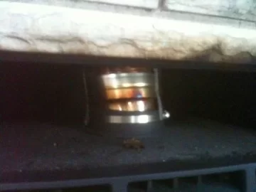

just realized my flue liner is sucking air at the connection to the stove thanks to the 'professional install'. so this would reduce effectiveness I assume(?)...what's the best way to seal this? I don't think I can get the liner lined up properly...are there adjustable adapters? or should I just stuff sealing rope? high temp silicone? furnace cement?
Can't hurt to cement the gap....
