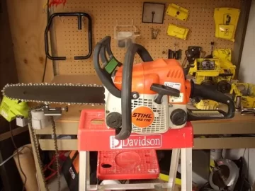

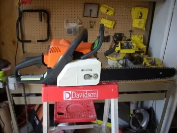

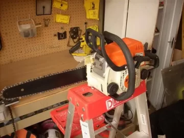

here's a few pictures of it post clean up and reassembly:

Looks Nice! Cant think it could be any thing but the coil.
I should have done before pics for it. It looked a lot worse, trust me. Guy who sold it to me asked me to let him know if i ever get it running again. When I do, i might just send him a link to this thread so he can see how nice it looks.
