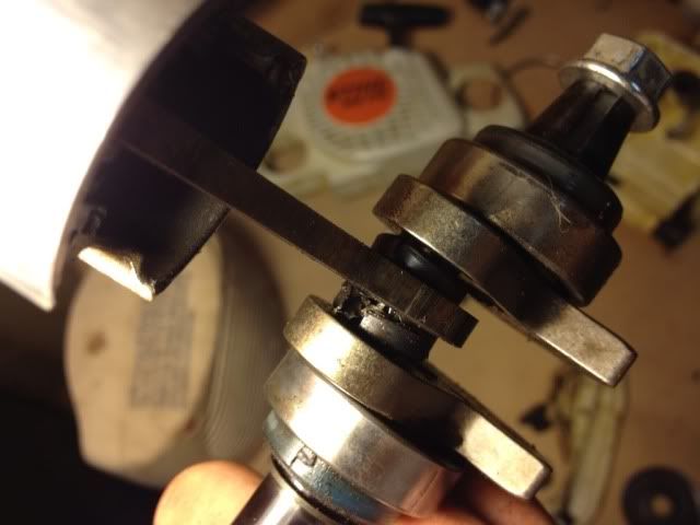

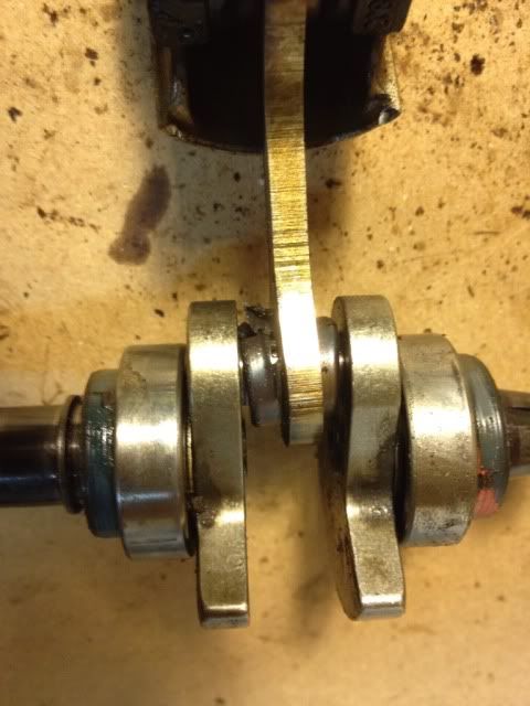

Just picked the saw back up a couple of weeks ago and I was getting spark, but no ignition. Not even a hiccup with starter fluid. Noticed there was no fuel, so checked the fuel lines again. They were kinked. Then I pulled the plug and left it kinda hanging there near the hole. Gave it a yank, and flash-flash-flash-flash. The spark was strong enough to ignite the fuel from near the hole, that's a good sign. I've heard, however, that if you have a weak spark, sometimes the compression hinders it from fully igniting the fuel. I was hopeful that my spark isn't the problem, I've tried two coils and three plugs, and messed with coil gap and plug gap, etc.
I have checked the piston from intake and exhaust sides and it looked nice, but there is only one way to be certain. That brings us today. Pictures in next post.

What do ya think? I think I found the problem. Luckily the p&c didn't eat anything from this that could cause damage.
Anybody have a junked 170 laying around. I bet that other saws share this, too. I'll check my IPL for a number and do some googling...
Anybody know if I have to replace the whole crankshaft? It's not serviceable? My IPL doesn't break that down...lame.
Part number: 1132 030 0401
I would look for something like this............ (broken link removed to http://www.ebay.com/itm/Chainsaw-STIHL-017-018-MS170-MS180-MS-170-MS-180-Engine-Motor-Crank-Shaft-Parts-/290623340615?pt=LH_DefaultDomain_100&vxp=mtr&hash=item43aa804047)
Dangit. It's just so expensive!
Might have one coming from an AS member. Will keep y'all posted.
Edit: got it for $10 to my door! Online communities are a godsend for this sort of thing!
