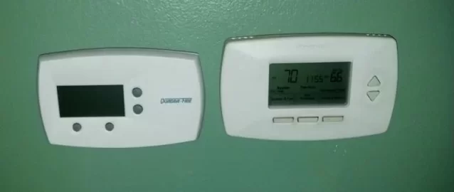

I made myself useful today and ran my thermostat wire and installed the thermostat on the wall. Thanks to balls of fire for his help. I used solid-core CAT5e cable since I have a whole spool of it.

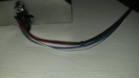

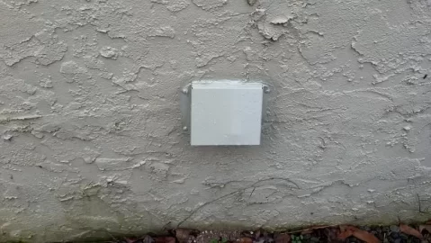

Here's a few pictures: the thermostat installation, the OAK intake outside, and the pinched optical sensor wiring...

Does anyone here realize how easy it is to splice a millivolt wire? My god.... if at least to get the unit running until a fresh part arrives. This is what happens when all the money is collected before the job is finished. LAZY! No motivation, complete lack of education, but don't feel bad...this is typical of the industry....a bunch of folks selling and installing a lot of stuff they know not too much about. You'll like the stove when they get it running. Out of curiosity, if you require a service call under warranty, who's coming out? Trained dealer employee or third party? Time will tell.
Trust me, I have resisted the urge to splice those wires myself, reinstall the sensor, and fire up my stove.
But since they probably have to return the part to HHT for warranty/credit, I am not going to screw with it.
As far as service, I know they have service guys that are full-time. The installer was just as pissed as I was and he told me he'd bring the part out himself if they'd let him. Shortly after he left, I got the phone call telling me that is exactly what was going to happen.

It took me a total of an hour to do the thermostat job from the moment I walked into my garage and cut 20 feet of cable off the spool to the moment I plugged the stove in to make sure the thermostat lit up. So, it really was no big deal and if I was told about it when I bought the insert, I would have prewired ahead of time. I am an IT guy and one of the things I do is pull cable. My entire house is wired for gigabit ethernet, so this was no big deal.
The whole OAK thing is what enrages me the most.

Interesting that the photo eye, it is called the Optical Assembly Kit was bad. It mounts on top of the auger motor. The screws are hard to remove the 1st time! I know of a couple of stoves where that needed to be replaced after 3 years and also the Flame was set too high in the thermostat causing more errors. Once the flame was set to -4 everything was ok.
