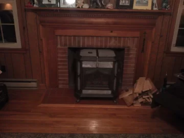

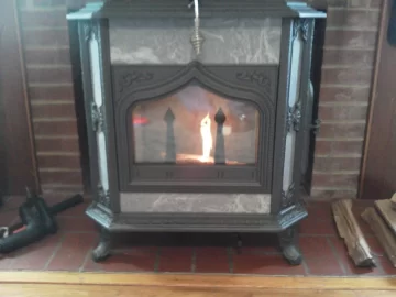

    Alright its been a long weekend with lots of heavy lifting but here it is in all its burning glory!! It ended up being just my FIL and me but it wasnt to bad getting the stove inside and set up we used an old quilt and a two wheel dolly to kind of push pull the stove through the house it worked great with only a few beauty marks on the floor. Ive had three small fires the first got up to about 100* the second was around 200* when it died the third was around 325* this thing is not only a work of art but a super easy unit to operate Ive never used a wood stove thats this easy. Ive currently got fire 4 going I put a bunch of scrap lumber kindling in it and a couple medium splits on top lit a super cedar and shut the door just turned the draft down to about half I think Ill leave it there until it burns out. I really appreciate all the help Ive gotten on here and hope that one day Ill be able to return the favor.

    Matt, it is beautiful! Can you still get that top lid up to clean?

    Yes it looks like its sitting back in the fireplace a little but its not its actually about 3" in front I can open the lid and it rests up against the mantel. The only problem I have right now is that my wife told me to let the fire go out since its going to be in the 60s-70s for most of this week:( Oh well hopefully it will get cold and stay cold soon.

    That's good Matt. Worry not, you will get to use that thing a lot yet this winter. I might also suggest that while the stove is cold, you could remove the two shipping bolts that hold the catalyst in. That way when you are ready to clean the cat you won't have to monkey with the bolts. When you do remove the cat, be sure to look at the frame good as there is a lip on one side and the cat needs to be put in the same way every time else it will not sit right and will not work.

    Matt,,, looks great! That's the first thing I realized as well coming from my Quadrafire 5700,,,, the Fireview is soooo easy to run,, just great... Don't mean to throw water on the fire but in the picture it looks like your really short on your hearth protection up front,,, needing a minimum of 8 inches from the stove front. I will tell you the hearth pad out front does get warm. Hopefully it's just the picture... Yup Woodstock stoves are in a league of their own,,, super heaters and a pleasure to run,,, set'em and forget'em!

    Your cup of water is appreciated and your eyes are not being deceived I am looking for a hearth extension pad or something like that. Anyone have any suggestions?

    Just remember 1 thing,don't get a rip roaring fire going all at once.Heat that stone up easy like.It could crack,believe me,it's not a troublesome thing but a good precaution.Boy are you gonna have fun with this.
