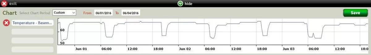

I somehow cleared my effergy energy monitor data but I just recorded one of my lowest monthly cost to run my geospring. The month of May cost me roughly $8.50 in electric costs for hot water. A big influence was the wholesale cost of power dropping from around .10 kwh to .6. With delivery fees and other charges it still comes in around .18 kwh.
The warmer temps and higher basement temp has helped as well. I hooked up a sensor from my weather station a foot away from the outlet to monitor the temperatures. My data shows it has almost no effect on my basement temp as it always stays the same. The geospring has been recovering in about an hour from an average shower using roughly .6 kwh.
With the rise of humidity I have been emptying a 5 gallon bucket every few days as well. Huge benefit to these is no need to run a dehumidifier anymore.
