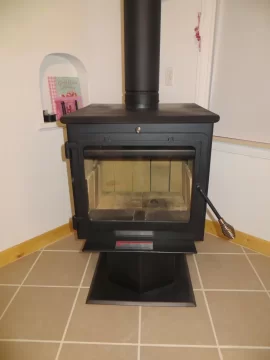

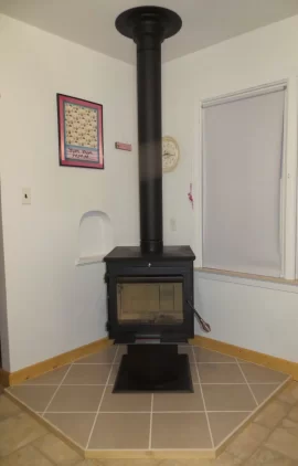

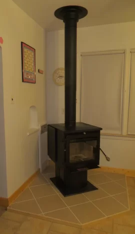

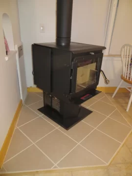

So I got the Englander Madison back in the first week of July, but have just put the finishing touches on my install. Everything is complete and the inspector is scheduled to come out this Wednesday. I'm really itching to fire this baby up! Did everything myself, and the hardest/most time consuming part was the hearth. Oh well, I think it turned out great, and even my wife loves the way it looks.. I've been scrounging like crazy and have about 9 full cords CSS. 3.5 or so of them are dry and ready to burn. Everything I know I learned through this forum and I really appreciate the community here, though most of my time is spent lurking and reading past threads for countless hours. Any questions/thoughts/advice/comments are surely welcome! I will try to keep this thread updated as the fall/winter progresses.
Just to throw this out there since there have been a few threads looking for places to buy these stoves: I got the stove though AM-FM Energy. Great people to work with, and I recommend them highly.

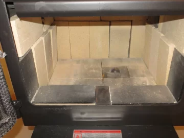

Nice install, its also nice to see some real pics of this much anticipated unit.
Pretty shallow belly, be careful with ash spillage. good view of the fire with that much glass though!
Looks really good. Im interested to hear how it burns. Congrats!
There is nothing shallow about that belly. It has normal doghouse height & a row of firebrick laying on top, so actually the belly is fairly deep compared to other stoves with the exception of BK stoves.
I still can't figure out that firebrick air disburser instead of the steel one in their other stoves. I guess the steel is under is and it is a design thing. Wondered about ever since I first saw the stove in DC last November.
There is is a deep, brick wide and high steel ledge created by the doghouse manifold that is unusual in this stove. I will be curious to see how this works out in normal usage. It looked like it would be annoying for N/S loading, but I haven't burned in one. It could be no big deal. Maybe it gets air under the coals better?
RopeS thanks for the pics. I'm looking forward to hearing how this stove heats and burns.
