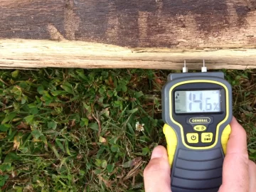

I too live in the northeast. Seeing this post motivated me to check the moisture of the pin oak I will be burning this winter. It was c/s/s July 2011 so by the time it hits my stove should be 29-30 months seasoned. For now call it about 27 months. Stacked single row facing N-S so it gets the E-W winds we typically have in my area. I took a larger split out of the center of the pile, split it again and took a reading and am below 15%. Give us more info about your stacks/process so we can try and help. [Hearth.com] My stupid wood is still too high in water content after 2 years !
I too live in the northeast. Seeing this post motivated me to check the moisture of the pin oak I will be burning this winter. It was c/s/s July 2011 so by the time it hits my stove should be 29-30 months seasoned. For now call it about 27 months. Stacked single row facing N-S so it gets the E-W winds we typically have in my area. I took a larger split out of the center of the pile, split it again and took a reading and am below 15%. Give us more info about your stacks/process so we can try and help. View attachment 113499
I think your meter is reading low. I've never had firewood that low. When you put it into your palm what reading do you get. Also check unpainted lumber in framing of your house.
