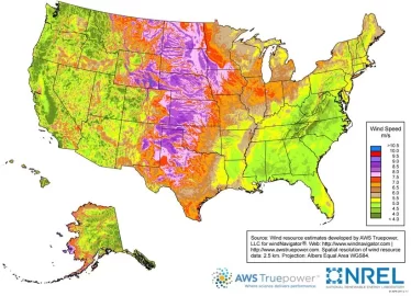

    That fable didn't come from NW IA, where you have some of the highest average wind speeds in the US. >>

    My wood is blocked from some of the wind due to a new building I put up so not sure how much wind I get on my wood now, just a few years ago many on this forum talked about how long it took to dry wood but no one said much about how they stacked it or where it was stacked, a few who said it took at least 3 years to dry Oak had their wood stacked in cubes.
    Wind is good but so is single rows stacked in the sun, no need to shoot your self in the foot when it comes to drying wood.
