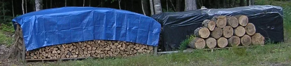

Here's my latest approach (on the left). I use 4 48"x40" pallets for the floor (so total 13'4" x 4') and one for each end. Two rows of wood, plus fill in the middle of the rows with odds and ends. Tarp is 16'x10', and with the seams and the crowning it's just the right length. It's tied down at all 4 corners, but I haven't decided what to do with the sides. I might go for the tent effect, although I worry that the november winds off the lake will shred the tarp if I hold it out like that. Ideal would be some sort of weighted bumper that holds the tarp down and away from the sides but still allows some play. For some other stacks I went with 12' wide tarps, which will let me reach (near) the top of the pallets on the ground.
My "problem" is a little different, in that I'm not going for maximum seasoning speed but minimum wetness. I have about 2 cords of deadfall a year, but I'm lucky to burn 1/2 cord a year since it's seasonal. I'm up to about 10 cords, and until/unless I put up a pole barn or a big woodshed I need to keep this wood indefinitely out in the yard. On the right (behind the uncovered logs) you can see last years approach - total plastic wrap on same pallet stack. It should last at least one more year, but it's not a long-term solution. That wood was already seasoned when I wrapped it, although I was worried about creating a solar still there seems to be enough air under the pallets and through the ends to keep it dry.
