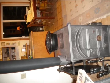

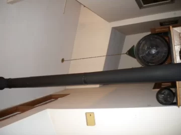

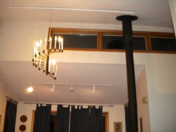

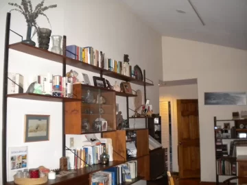

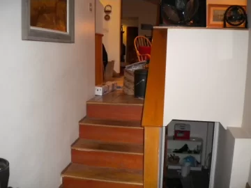

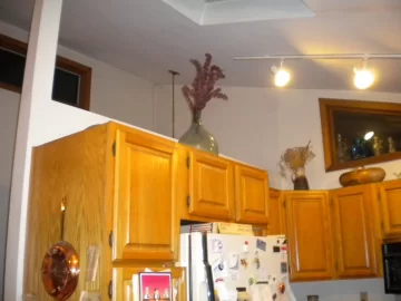

A couple of pics might help.
At the very least (depending on stove), ember protection is a requirement unless you are on a non-combustible surface (read: cement). It just is.
I am currently picturing your house like this::p
A hearty laugh is really great for your health--the pick sent me rolling.
I put pics on if it helps--not sure about the technology but I will try
I have ceramic tiles over wood. I have info from several sources, including manuals--that this is ember protection.
If the pics came through they go like this:
1. from entrance vestibule up to main floor (stove behind half wall)
2. opposite direction--from stove to entrance area open space--wall on right is back of cabinets
3. living room ceiling
4. to eating area--stairway down left between stove and counter , counter separates LR from kitchen--kitchen to left
5. kitchen cabinets--on other side in entrance area
6. with stove to my back--dining room to bedroom door[Hearth.com] Need help on final choices[Hearth.com] Need help on final choices[Hearth.com] Need help on final choices[Hearth.com] Need help on final choices[Hearth.com] Need help on final choices[Hearth.com] Need help on final choices
So my mental picture wasn't far off, eh??;lol
