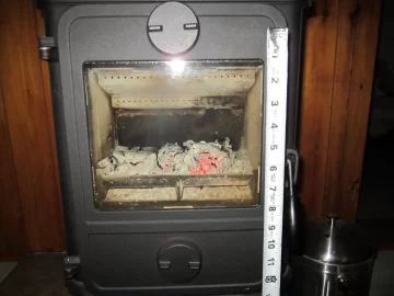

Hi, I'm heating 750 sq ft well insulated with lots of south windows near Ottawa with a morso squirrel 1410. It keeps the place warm enough using good hardwood and I let it go out if the sun comes out unless it's below -25C. On warmer days a quick "Flash Fire" gives heat for a couple of hours. Loaded up and turned low before bed there will be a few coals left in the morning and the house will have lost a few degrees.

Squirrel, sounds like you have a nice passive solar design. My folks built and live in something similar... if it's sunny on a January day even at -20 they don't need any heat. Pretty cool. Do you have any photos of your stove firebox? I'm having a hard time grasping how big of a stove it really is without taking a trip to Toronto to see the closest dealer.

Squirrel, Thanks for the photo! That little guy looks awesome, and I still can't believe it heats your 750 sq ft! Do you do any overnight burns with it? If so, how long does it last for?

I don't do overnight burns. The stove will give off noticeable heat for about 3hrs if loading hardwood on a coal bed. The trick is having decent insulation and air sealing. I don't have make up air and the total air inlet area on the stove is only about 1"sq , the house probably leaks way more than that! I do have CO detectors though.
Before buying the stove I used electric heat for one winter so I could measure the Kwh I used and knew the stove was big enough for a few days at -40 and windy.
