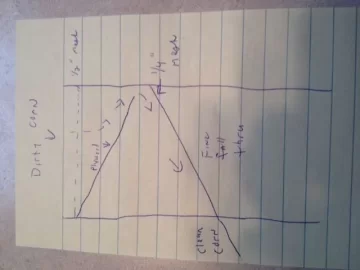

I built a cleaner myself using 1/2 hardware mesh and 1/4 hardware mesh. it is 1 ft square w/ a 1/2 mesh screen tray in top to catch cob and stalks. Then a ply wood ramp at 45deg w/ a opening about 1 1 1/2 inches then the corn runs down a 45deg. 1/4 mesh where the dust and fine fall thru. this does a good job at minimal cost.
here is a drawing for cleaner
