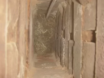

Here is the picture of the kitchen chimney, looking up. I took it with a digital camera with flash. Any suggestions on how to dislodge this mess? I think some of the loose bricks at the top of the chimney have fallen in, above the nesting material.

Sandy, you need the services of a chimney professional. Rick
I live in real rural town and the guy I paid $125 to was, supposedly, a 'professional'.
First, on the form, he wrote 'not okay to use until blockage is cleared'. That's when I snatched the check away from him and said I didn't want him to leave until it was fixed because I would be firing up the gas heaters in about a month. After about another hour, he said it would be 'okay for gas but not wood'. After seeing the pictures I took last night, I realized that the kitchen flue is NOT okay for gas either. If this house were air tight, I'd suffocate from the Co2 being blocked from getting up the chimney - not to mention the damage to the interrior brick from condensation.
Rather than pay him another cent, I'll just keep poking away at the mess untill it either breaks loose or I can see more of what's above it...then I'll call a professional chimney mason to do repairs.

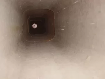

Bite the bullet for now, but send us some pics of what you're talking about...pics really help us understand your particular situation. It's crystal clear in your mind because you've been staring at it for some time, but when you say something like, "The flue opening in the other room (where I want to put it) has a hole cut out in sheetrock (covered with wallpaper) with the wall framing between this and the brick.", well, that's a little tough for me to picture. Heating your home with a woodstove isn't something you want to implement in a hurry if you've not done it before. It's simple in principle, but can be a bit complicated in execution. And even very dangerous if not done correctly. Welcome to the Forums! Rick
Good point. Here is what I have to work with:
This is where I want the stove to go.
(living room coverted to main bedroom, dining room converted to living room to the left, between kit. and bedroom. Other bedroom/office/sewing room behind this room)
