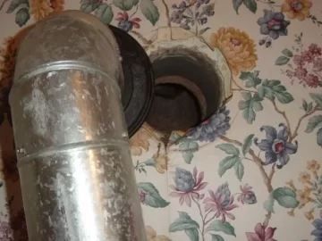

Close-up of pipe connection from existing gas stove...

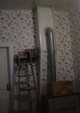

Bedroom/office/sewing room with gas stove connected...
btw, the kitchen chimney/flue looks just like this one.

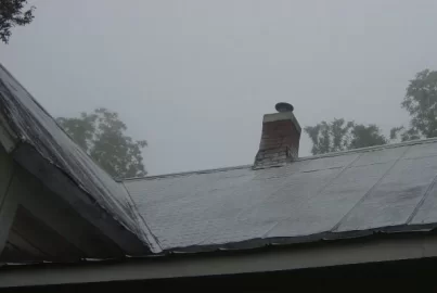

Outside chimney...
btw, the kitchen chimney is half as wide (not square), not as tall, and cap is missing.

Hi Sandy, if it was my house I would get a thimble kit with a triple wall heat shield system as well as a some sort of heat shielding on the two walls, maybe some sort of hearth shield or have a mason install a nice brick hearth. . There is no way I would run a woodstove in that set up without some major changes. Spend the extra money now and do it right or wait till you can afford it.
If I'm reading this correctly, you want to put a woodstove in a bedroom. If that's the case, one of the first things you should probably do is run that idea past your local Authority Having Jurisdiction...county/municipality building/community development/safety dept or whoever thay may be. Some jurisdictions prohibit installation of solid fuel-burning appliances in bedrooms. This may well have some bearing on the direction you go. Rick
I have no idea what this means. Can you explain it in detail...with pictures if possible. lol

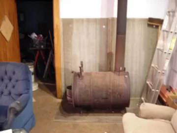

What do folks do who have a one room cabin to heat???
We use one of those scary barrel stoves. For a few hours in the evening. I would definitely not use this in the house but in a 100 year old drafty ranger cabin, it works. In the "good old days" they used to have 4 people staying there 24/7, I'm still trying to figure out how this did this!

Here is the picture of the kitchen chimney, looking up. I took it with a digital camera with flash. Any suggestions on how to dislodge this mess? I think some of the loose bricks at the top of the chimney have fallen in, above the nesting material.
You can't use this chimney without relinning it first. That is an old style chimney, no clay liner like the other chimney has. It would be against code and dangerous to use this without a reline. You can find stainless steel liner kits on line for $400.
We use one of those scary barrel stoves. For a few hours in the evening. I would definitely not use this in the house but in a 100 year old drafty ranger cabin, it works. In the “good old days” they used to have 4 people staying there 24/7, I’m still trying to figure out how this did this!
Good grief! That is scary.

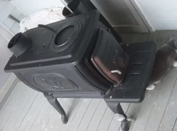

Still, I am getting all negative reviews on this particular stove so, I think I will return it for something more substantial.

Hi Sandy, the thimble set up I was mentioning is in the last link in fossil's thread. It fits into the chimney or liner and alows a gap/air space between ite pipe and the combustable wall. You can have a certified installer do it if your not comfortable doing it yourself. You might want to look around for a good used stove that is in good shape rather than a lower cost stove new.

Sandy, you have gotten lots of excellent info from the other posters. But......get rid of that stove. That thing is NOT safe for a home install. Period. Not even temporary use.
This is just my opinion, of course, but you seem to be a safety minded type person. Return it while you can. In the future, if you choose to go the way of wood, get the stove of your choice at that time. That POS would not even rate storage area in my place.
