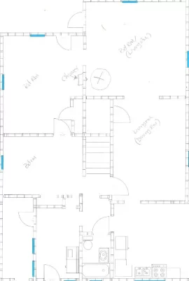

Here is a plan of my house. The 'X' in the circle is where I want to put the stove. I have 9' ceilings and a full attic over the front bedroom, the 'living room', 'dining room' and kitchen. The two front rooms are finished, the room over the dining room has a floor and wall insulation and the room over the kitchen has only floor insulation. I have a metal roof. The front of the house faces east.
Suggestions are welcomed. :coolsmile:

Okay...update.
I had a professional mason look at the wall last night and he said to cut away the sheetrock around the flue opening to expose the brick/masonry behind. Other than that he saw no problem with my set-up.
The chimney 'inspector' is supposed to come by today to clean out the kitchen chimney. I'll also get his approval on the other chimney.
Sooo, I think I'm sticking with my previous decision.
