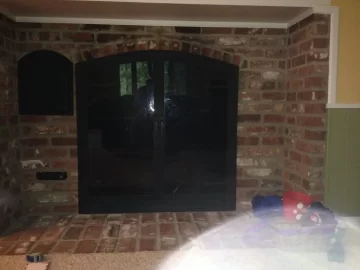

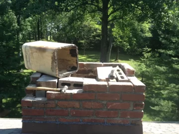

After more than a year & a half of deliberation we finally have a stove on order! We chose a blazeking king classic. Now it's time to get busy! Here is a pic or two to show what we have done so far. We plan on installing the king in the old firebox like an alcove instal. Damper and part of smoke shelf already removed. Ready to drop in liner and wait on stove to arrive

Nice chimney flashing work! Best stove selection too!

New stove will sit 2" inside of the fireplace opening. Clearance space for top of stove is 49" but how far out from front of stove does that apply? I'm trying to figure out if I need to remove a wood mantle above the existing fireplace.

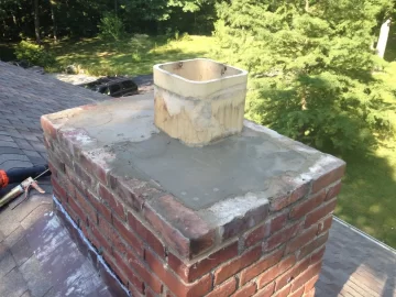

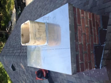

Nice chimney cap, you just gave me an idea to fab one up for myself.
Excellent chimney cap...did you seal the brick?
No you should not seal the brick. You will be much better off if you let that brick breath. You will probably end up having to repoint the rest of the chimney soon also by the looks of it. And yes insulate it it will work better and unless you have 2" to combustibles all around that chimney it is required by code.
Given the already low flue temps of the BK, I would insulate it.
There are no negatives to an insulated liner.
I didn't seal the brick but should have, didn't think of it. Uncle made chase cover/chimney cap for me.[/
OOOhhhhhh...don't know about that! Want to hear from the masons on this one.
No expansion joint around the clay liner?
Why such a big gap between the clay & the sheetmetal cap?
Hope you worked that silicone in good.
Set up look nice. Insulating the liner can do nothing bad, but can be a plus on performance.
Hogwildz thanks for ur comments, I've read ur advice on the other threads.
Big gap = a freebie piece of stainless my uncle broke for me @ work. Lotsa silicone it's cheap
On the 1" gap around the clay. Do masons (I'm not 1) typically put a gap on the mortar cap? I just put it back like it was with a little fall for when the silicone breaks down.
Yes there should be a small gap we usually wrap 1/4" foam packing around the clay then pull it out after the concrete is set and caulk the gap.
Any good mason will tell you this unless the brick is abnormally porous in which case they should have never been used outside. Sealers are a band aid to cover up deeper problems and if those sealers don't let the brick breath they will end up doing much more damage.

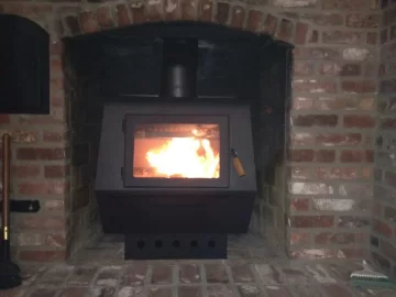

That's a big fireplace. How is it reaching the t-stat knob?
Did you get blowers?
BKs are by far not the best looking stoves available, but their performance ranks with some of the best. Nice job on the install.
Looks perfect in there!
Looking good! That is one bad-ass wood stove install.
How about more of a backed off shot to see the room more?
How is it working out with the thermostat? I've heard that close quarters mess with it's operation.
Begreen not sure what affect the tight quarters will have on the entire operation of the stove. T-stat isn't awful to get to but fan rheostat is a challenge. We just had a small fire to test drive our install. Still have more work to do. We have a clearance issue with the mantle, shoulda taken it out before hand.
Hotcoals I will step back a little further next time.
