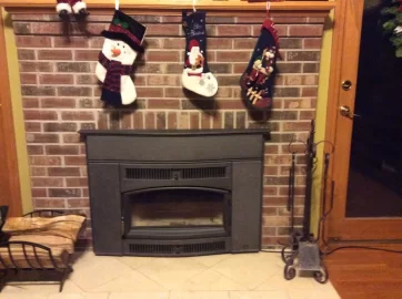

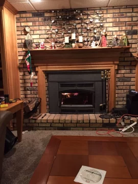

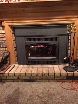

i am like a little kid at Christmas! Had my new cape cod insert installed today with new insulated liner. Doing the low/slow curing burn now. It is already putting out more heat than my old indoor camp fire I used to have:eek:. The dealer told me that it will run me out of the room if I want it to. I can see already it will take some getting used to though. I've never had bypass doors or secondary burns. I have to wire in a plug in closer to cords, but for now I have a drop cord running it because I couldn't wait to get burning==c
Thanks to everyone that helped in my decision making process
Here are some pics. I will try to keep updated thru the week with what I've noticed.

Sweet looking install. Does the surround not get hot? I don't think I could have mine as close to the mantel as you have it.
Looks great...enjoy.....
The surround gets warm, but you can still put your hand on it without burning. I made sure to check and the minimal to combustible measurements were from firebox itself. It had me worried at first. And it was luck the surround fit so nicely with old mantle
Yeah, I was worried when I saw that but it looks great.....
Top, non-combustible facing is supposed to be 39" from hearth to the wood. 41.5" to mantel. Though maybe the top frame lip of the surround is acting like a mantle shield?
Grisu and Begreen top of the surround never got hotter than 200 degrees of Fahrenheit. I have stockings hanging from my mantel, they never got even warm and I checked when stove was hot running full bore.

About how big of splits are you using. Does the insert show a lot of flame when burning wide open. Played with mine a little and am not getting a good flame, also don't think it's putting out the heat it should. I did get an overnight burn, which is something I've never experienced:eek:. I think my splits are a little large and I cannot get firebox full. Moisture is 15-16 on fresh split face of cherry. I checked about 5 pieces and all were in range. Also do you stack your firebox both directions?
The room it's in didn't get over 71 last night when I was on high. Turned it low for overnight and was about 69.

You have to get the stove hot I can't inmplement it enough. If I get the stove going good sometimes it's scary to look at it. I like to load S/N but due to its shallow box it doesn't happen to often. Usually I can fit 4 large splits E/W or I will put two big ones on the bottom E/W and four Eco Bricks N/S. But you have to get the stove hot. You will know when it's hot. Glass will radiate a lot of heat.
I think that's the problem getting it hot. The glass does radiate heat but I think it should be hotter than it is. Almost like it's not getting enough air. When running wide open should it be flaming up good or just a glow from coals
A lot of flame. You should always have a bit of flame going. When you setting for a long burn you have much less but you should have a little bit.
See I'm not getting much flame at all. I have to open door to get flames. Does it draw air from front or back of insert. I've tried moving ash to back maybe I'm going the wrong way. I've looked in the manual but it doesn't say
Your install has more than the minimum requirement for face clearance. It looks like your install has around 50" before the mantel wood starts.

You have that dog house in front, middle on the bottom. Don't block it with wood. Maybe your wood is not as dry as you think? I know it's very sensitive to quality(moisture conten) of wood. With a nice dry wood I can take my house from 60 to 70 on a single load if the temps outside are no lower than mid 20. Get IR gun and see what you are getting for temp on your stove.
I'll see if I can get one. It seems more like an air flow issue because when I crack open the door it takes off really good. When door is shut and air is wide open it just makes lazy flames and they eventually go away
