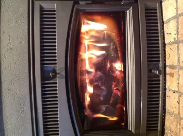

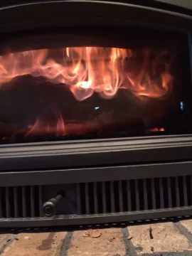

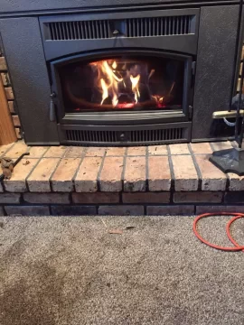

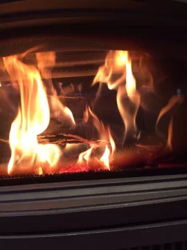

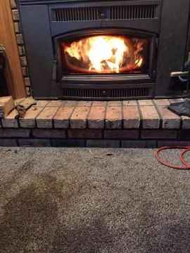

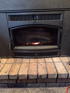

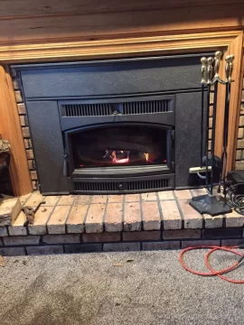

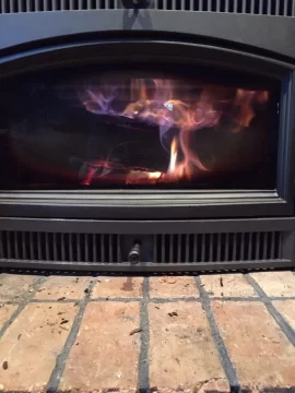

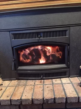

. Also I am not burning on high. Probably half way open. Maybe closing air down the secondaries are working better?
. I am wondering though if it still isn't burning real good because it seems to me that I have a lot of "charcoal" instead of ash. It's like the coals don't burn all the way. Is this normal or should I have more ash ?
