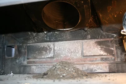

Hef:
You have the same setup that we have - a Clydesdale connected to an insulated Flex King Pro, 6 inch SS liner. We are going into our 4th year with this combination and we have no complaints.
Prior to connecting Clyde to the liner, I built a mock-up of the insert using thin plywood stuck together with hot-glue. I did this because there was minimal overhead space to connect the liner to the appliance/stove connector and I wanted to see how things would line up. See http://www.chimneylinerdepot.com/store/427/product/Flex-Liner-ApplianceStove-Connector-6-inch.html. When the mock-up was in place under the liner, I could barely get my hands behind the stove to insert/attach the liner into the connector.
After experimenting with the mock-up, I decided the best approach was to insert/install the stove connector into Clyde's flue collar (while Clyde was sitting on the hearth and it was easy to get to all sides and the top of the unit), slide the stove back into its final position, and then connect the flex liner to the stove connector. That third screw in the rear of the flue collar - no way I was going to get that last screw in if I hadn't put the stove connector in first - and then push the stove back in place.
I dry fit the stove connector into Clyde's flue collar - it was a little bit loose - so I took the stove connector back out and generously smeared Rutland Furnace Cement (see (broken link removed to https://www.rutland.com/p/20/chimney-sweep-furnace-cement) on the male end of the connector, pushed it back into the flue collar and then tapped it with a rubber mallet to seat the connector into the flue collar. Then using three SS screws, I fastened the connector to the flue collar.
With the stove connector fastened into the flue collar, I pushed the stove into its position under the flex liner. Then I repeated the process smearing the Rutland Furnace Cement on the end of the flex liner, which I then slid into the female top end of the stove connector. I then tightened up the SS clamp on the connector, covering the clamp with the furnace cement.
By the way, there is an up/down orientation of the flex liner.
So far, we have had excellent results with the stove/connector/liner. Clyde heats like a champ - we get no back puffing - the draft is excellent - and the stove is vey easy to start. We have had very little creosote after the first three years of burning. See the photo of the results from cleaning. You can see the stove connector/liner/flue collar in the attached photo.
  • [Hearth.com] New Clydesdale - First Post
