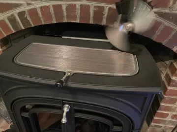

Our flexburn stove is doing a fantastic job heating the main part of our house. As you can see from the photo it’s being used as a hearth stove. The bricks in the arch are very warm to the touch (about 2 sec is all I can touch) and the surrounding area is staying cool and within clearances.
Should I be concerned about the arch bricks absorbing this much heat with only a few inches clearance from the back of the stove and ducting?

Well, bricks don’t burn, so they will be fine. Depending on how that fireplace was made you may have to worry about framing behind it catching on fire. The OP took such a small photo there really isn’t any way to tell if there is any danger from the bricks getting hot.

If that's an all masonry fireplace those bricks getting hot shouldn't be a problem as there shouldn't be any combustibles any where near there. Now how it's actually built is another thing.

When cold they will absorb some heat, when the stove cools you will get some of that heat back. Hope you have a block off plate to keep the heat in.. Good to hear that your stoves running well.. dont let the nay sayers get you down.. a good install and proper stove operation goes along way

I doubt your bricks will have much of a problem. The cement used for the bricks may be an issue if they used a crappy mixture - but it's doubtful unless you've noticed loose bricks before. What's behind the bricks and how far back would be my question. You are to remain 12" minimum from all combustibles. That INCLUDES anything behind brick etc. If within 12" there is anything combustible you are at risk. If you arent sure, I would consider extending out the heart and pulling the stove out.
Good luck with your stove, keep a nice hot large bed of coals going and make sure you are using <20% moisture content wood, and you'll be fine. It's a tricky stove to operate and has caused me a number of gray hairs learning it as I have the same exact stove w/ the cat. Keep it above 475 if you run it without the cat, and inspect that chimney every few days at first for creosote build up.
