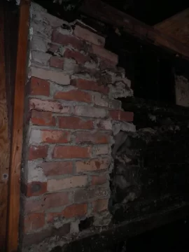

The bricks that were slapped in. Very crappy job.

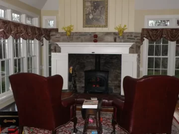

Okay... found some pictures I took previously of that fireplace. This is the fireplace that was part of the 1773 summer kitchen until that was knocked down in 1994 to make way for the new addition you see here. Fireplace opening is 5' x 5', and fireplace is 5' deep behind the doors. Non-combustable surface in front of the stove is about 4', and mantel height is over 6'. This one is sporting a newer brick chimney outside, and may have had some of the same wood-in-chimney construction I described for one of my other fireplaces in another thread. Click on the thumbnails for bigger photos.
[Hearth.com] New guy looking for stove advice. [Hearth.com] New guy looking for stove advice. [Hearth.com] New guy looking for stove advice.
