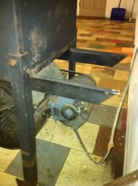

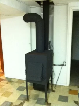

I just recently purchased a house that has a wood burning furnace in the basement.
I have just found out that it is the original Johnson Energy Systems Furnace from 1977. I believe it is model 1100.
My insurance company will not cover it because it is not UL listed. I'm wondering if I could purchase a new blower for it to satisfy the insurance company.
I'm very new to all of this, so I appologize if this post is in the wrong forum.
Does anyone have any thoughts or suggestions? I would really love to start using it, the cost of propane is killing me already. I've only been in the house a month now.

Don't bother, changing the blower wouldn't make it any more insurable.

Well, that's up to you. Safety should be the number one concern. Cosmetically, outside doesn't look too bad, but we have no way of knowing it's interior or working condition or whether it would be safe to run this season. For sure you will need to have a chimney sweep clean and check the flue out and give you a report on it's condition. That is going to determine a lot.

In order to assess options and where limited funds can be spent, you need to think to the future. There are pros and cons to any decision. My general inclination would be to first know what I have starting off. You need some trained eyes for this. The sweep can assess both this flue and the fireplace flue to confirm that they are different pipes (they will need to be if legal) and will give you a report on both.
Ask the sweep to also look at the old Johnson. If it's in good working order, I might consider running the rest of the season with it, putting aside the money that would have gone for the propane and saving it for a new insert for the fireplace. Depending on the condition of the flue and the condition of its flue an insert might be able to be purchased and installed with a liner for under $2500. That would have the benefit of good heat, nice fireview and lower wood consumption. The downside being that the basement would be unheated (though you could still cycle the propane furnace once a day to warm up pipes there).

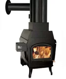

There is a manufacturer of wood stoves in Canada that makes a stove designed for connection to an air distribution system. J.A. Roby is the company. The stove looks like this pic.
Here is a link to a local retailer in NS. http://www.ujr.ca/EN/ja_roby_stoves.htm
Not likely you will be buying from them, just to say that there are solutions that are less than a full scale wood furnace.
