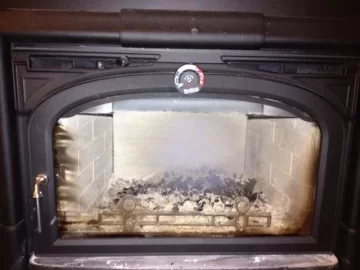

KaptJaq -- I don't have an IR thermometer. Looks like I should get one. The magnetic thermometer the installers left says I don't go above 500F, but I'm learning from this forum not to trust the magnetic ones too much.

Where did they place the magnetic thermometer on the stove?

Here's a picture -- right on the peak of the door.

I've got a PE Super 27. I just put my IR Thermometer on the spot on my door where your thermometer is and it read 200 degrees cooler than my stove top. Place it on the top of the stove.

To me 500° sounds a little hot for that location on the stove. Were you burning a really hot fire? I see some soot streaks on the glass near the latch. It should look more like the other side. Was the door completely closed and locked while you were burning? In the picture the primary air lever is in the closed position, was air leaking in between the door gasket and the frame?
Once the stove is burning that door should be completely closed and locked. If air is leaking in at that location the handle may need to be tightened. Do the "dollar bill" test. When the stove is cold put a dollar bill between the gasket and the frame, close and lock the door, then try to pull the dollar bill out. If it comes out very easily you need to adjust the handle.
Seconding this. Not only are cheap magnetic thermometers unreliable, but that's also the wrong place to put one. Unfortunately it's a little more challenging to measure temperature on an insert than on a freestanding stove.

I have a Montpellier and I get readings in the mid 500's from that location using an ir thermometer
