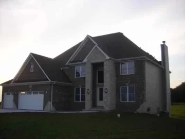

I have been asked to build a appealing to the eye way of hiding my wood pile.
Here is the house I don't think there will ever be a house 2 nice to have the comfort of wood suplimental heat

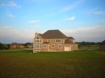

Nice house! I would build a similar style (roof pitch) detached structure in the rear of the house. Probably oposite, what looks like a garage door in the right picture.
I was going to build back on my lot line you can see my current wood pile.
That's why I wanted to build 24 wide x 5ft deep. I know they will want me to do some landscaping around that area to further hide.
I think the wood pile looks great but some around here don't see things the way I do

Nice looking house ...but where are the trees?????
Oh, there they are :lol:
Wow.
The wind must get brutal. No wonder the wood stove.
Can you plant some? Wind breaks, etc?
Just askin' :)
all in good time
But back there the pile gets tons of sun and wind so it's the perfect spot just need the ground to thaw so I can get the 4x 4 in the ground
