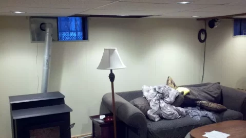

Hey guys sorry i had work and some stuff going yesterday but yes Smokey and Mark you are correct. I have no air vents just hot water baseboard heat. TO add to Smokeys post yes i have 3 vents already cut in the floor. LR, Kithcen and down the hallway. What i did is like Jason stated. I went to home depot yesterday and bought 2 register ducts for under the floor. I added a exhaust fan to each one with a adjustable, directional 6 inch diameter piping asnd screwed it and wired it to have them suck into the basement. I could feel the cold air before falling in to the basement so i wanted to help move more of the cold air down to be reheated and make pressure to have the hot air rise up the stair way. I left the LR vent alone as one it is right near the stove and 2 ive already spent a good chunk of change on all this. Also like SMokey stated i tried a Poor mans way with blocking the stairway for the time being. I laid big blankets over the railings before spending money of boarding or plexi to do this.
Here are a few picks of what i did.
This one is in the laundry room and is sucking air from US to the basement. I have it pointed to blow towards to room with the stove. Then i have an ocilating fan halfway between blowing towards the stove. The ocilating fan is stationary and not moving.

Smokey , MArk , Jason, am i correct in have the fans blow the cold air down to the basement. My wife thinks i should have it reversed and blowing the warm air in the basement up into the main floor thru these vents....?

Cold air is easier to move than warm air...
Do like I said and try it with it blowing up first. Let it run for an hour or two without any of the other devices.

well i did try the other way blowing hot air up with the duct fan but was not working to good. From the picture you have i have the same setup and this was the best way in my house(same stairway with open rail and blocking the rail so cold air will not go into the stairs and make a air block). Also did put a fan like you did to push hot air up the stairs but did try without it and feeling less draft in the house. i just let the air go up naturally. But your,re correct having the fan blowing cold air down to the basement. You can try it other way around and see what it does. Do some test to find the right path for you air. Did you find any difference so far with this setup. But you have to let the air circulate for a few hours and then see how your first level heats up.

Do you think blowing up would work . Wouldnt the warm air fight the cold air that is heavier and wanting to fall? ALso i stated that to her last night about just running more duct to in front of the stove. Thats gotta wait as shes mad at the money i have spent lately of possible solutions to this. But i like figuring out stuff and spending money to see what works and what doesnt.. hahahaah

Pushing cold air down the steps will yield better results. As cold air is more dense and will be replaced by the natural rising warm air. Laws of thermodynamics. Easier to get the cold to warm.
Looks like your on the right path. Shouldnt need any more holes. Just need to get the air to flow through the ones you have. I would blow cold down the steps, and pull up from the holes/registers.
I cant get my upstairs to 60* if I try blowing air up. Blow cold air down and can get it 70* with the woodeater.
Get enough air movement and it may not matter whats doing what. But then your gonna have 10 fans running and the noise that comes with them.
If the fans in the duct are forcing cold air to the basement area and the fan in the stair well is doing the same. Your not creating a good loop. I'd reverse the fans in the duct to force the warm air upstairs and leave the fan in the stair well to force the cold air down stairs. Should give better circulation.
Or do the exact opposite. But don't have all the fans doing the same thing!
I may have missed it, but I didnt see where you guys spend most of your time - upstairs or downstairs? If upstairs then I think you should put it upstairs. I have a split level also and have our stove upstairs, downstairs is finished and gets down to about 50 in the coldest weather but were ok with that.
My choice would be to have the fans pull the warm air from the cellar ceiling and push it up through the vents. The cool air return would be down your stairwell. You could also remove the angled elbows on the booster fan.

Ok im getting a little overwhelmed. I thought putting in the vents in the floor would allow the hot air to rise as it gets stuck to the ceiling downstairs. I did put in the booster forthe vents and had them suck down as i thought cold air is heavier therefor at the bottom of the floor making it easy for the old air to fall. I know this negates what i just stated as warm air rise but i would use the stairs to allow the warm air up. I did go DS and reverse the booster for the kitchen to blow air up to the living level. I left the one in the laundry room as it is farthest from the stove to still suck cold air down. Im not drilling more holes, not at least until i get a definitive result or answer on what is working for me.

I could have the room upstairs i would have to move stuff and that is my last ditch effort. I think i can make it work in the basement i just have to keep playing with it.
Yes the DS before the stove was always a smidge warmer than up i think due to the furnace room.
Here is my UPstairs
and downstairs

My point was that those two little vents aren't going to do diddly to let enough hot air upstairs. You need to go BOLD IF you are committed to keeping the stove in the basement. I used to have a tri-level with a coal stove in the lowest level. I put one of those large grates in the hallway upstairs and immediately had a RUSH of hot air come through the hole. My third level was almost as warm as downstairs.
Of course, you have to be committed to cut a large hole in your floor between floor joists but it will work. Even if you eventually decide to move the stove upstairs, you can block off the floor vent and still have a very attractive ornate floor decoration.
First ditch those elbows, have the fans in those ceiling vents blow upwards, remove all other fans. Try that for at least 4 hours and let us know what happens.
This brings up the question of how much heated air you are going to get up through those vents and the fact that your stove can only provide 160 CFM of heated air at maximum burn (two hours per air exchange assuming things that don't actually happen, hence the 4 hour evaluation period).

Just so everyone understands this is a test the only direct path to the floor of the basement where the cold air is wanted is down the stairs, without a means to section the air in the stairwell off into two parts effectively we are going to reverse the air flow first and see what happens.
Smokey not arguing im just curious as i dont know, why ditch the elbows. Also since i only have the three vents so far, and only have 2 of the fans, would it be more sensible to have the booster fans at the 2 vents near the stove (without elbows) and the one in the hallway just gravity drop the cold air? Also from my drawing (hahah) so would adding another vent near the couch in the LR since it is an exterior wall and would be about 3 feet away from the stove but in the path of the blown air? Would that be helpful?
If im reading it right the exterior vents would have a downdraft. Then the cold air would push the hot air up the stairway creating a sort of mushroom effect. until the point it starts recirculate warm air and the house stays at a consistant level....?
just go with the setup you have
pull cold air down with the setup you did yesterday and let the air rise from the stair
see how it works. then youll see. start with those two paths.
