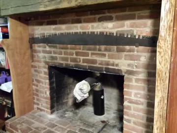

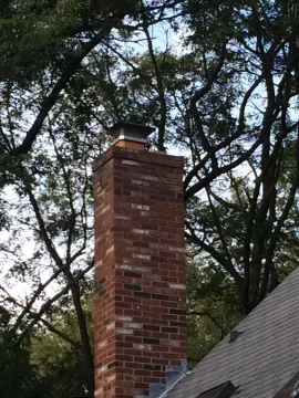

02_ Chimney - showing two flue's at the top. The Flue that comes into the fireplace has a cap on it. The other one was left open by the contractor who did some work for me. Since it runs into the firepit, it won't be an issue (those were his words). I dont' think that is going to be an issue.

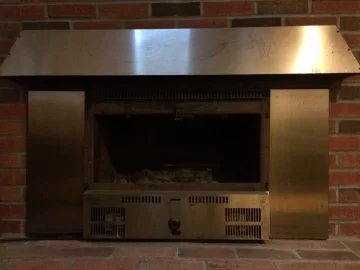

03_fireplace - shows the fireplace with the wood stove insert in its full glory. minus the doors which are out for service.

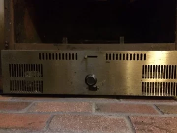

06_fireplace - shows the blower motor in the bottom. The slider above the dial opens and closes the airflow in the bottom.

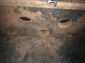

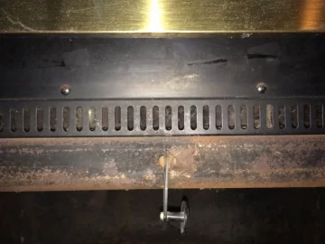

07_fireplace - shows the tubes / flues thru the vent where the warm is supposed to come back to the room (it is only my guess).
012_fireplace - shows the 5 flues (3 inch diameter) on the top of the unit.

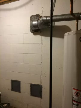

014_ash_pit - shows the ashpit and the hookup going into the hot water heater (gas powered).

I just tore one of them out of a customers house yesterday. And i would not use it. It is installed by just sliding it into the firebox with no real connection to the chimney. And with that stove there is no good way to connect it. They do not burn cleanly and are very prone to chimney fires. And due to the fact that they are not really connected a chimney fire can be very intense and dangerous. So while the guy at the stove shop may have exaggerated some points he was right it is unsafe.
so there is no real metal pipe running thru the chimney from the wood stove insert?
How old is this model? Is this from the 70's or so?
One of the fireplace guys who came in to do the liner for my hot water boiler told me that It is all set to go and only needs a new panel and gasket and everything else looks good..
What is the real cost of a new wood stove insert including installation? My house is about 1700 sq ft.. I think a 2000 sq ft unit might be sufficient..Also what is a reliable brand?
yeah i think it is 70s
No there is no connection at all and there really is no way to do it. It is a bad setup that does not meet current standards and cant be brought up to code
