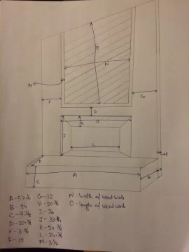

I was able to slide it out, but couldn't get it off the hearth as it is a bit heavy for me to handle by myself. So far I can get the measurements of the opening and it is 27 inches(height)x 33.5 inches(wide)x 21 inches (depth).. It tapers as it goes in.. Hopefully I can get all the measurements by the end of the day when I get some additional help.. Couldn't find any free standing stoves that fit that size of an opening..

Please see the measurements of my fireplace..
fireplacemeasurements01 - shows the entire fire place and the measurements..

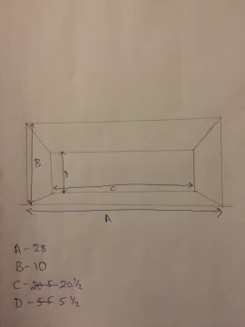

Fireplacemeasurements02 - shows the opening from inside the fireplace up to the chimney with the metal door where it tapers to the top.
Please let me know if there are any questions and waiting for your replies..
