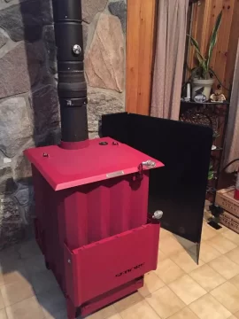

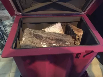

Trying to upload a picture, but pics have to be on a remote server it appears.
  • [Hearth.com] Newbie

Kool pictures it’s nice! How tall is the chimney?
Hoo boy, haven't seen a whorehouse red stove in many years here. ;lol j/k
Looks like a nice setup, is there a draw collar on the stove pipe? If you're curious and get a chance, take a thick split and moisture test as noted previously.
Reactions: mechanic100
Thats pretty cool!

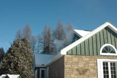

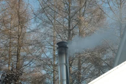

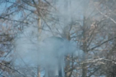

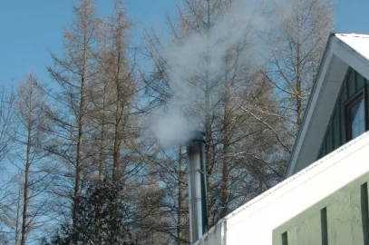

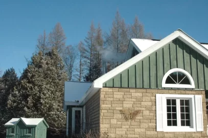

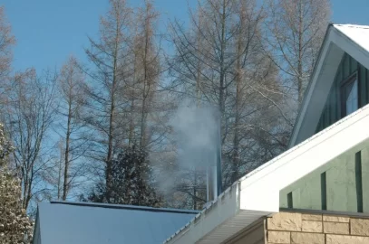

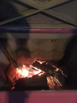

OK, so is this a normal amount of smoke?
My old stove never showed this much, but you could see the heat rising from it.
Stove is on full in these pictures.
It is usually worse than this though

I was trying to figure out what the bulge is in the stovepipe about a foot above the stove. My guess was a draw collar, but that sounds incorrect. What is it?
That does seem like a lot of smoke. Do you have some pallets you could break down or some clean construction cutoffs that you could mix with the cord wood? If so, try that and see if it helps clean up the smoke.
Looking at the pictures BELOW the blacken cap it looks like PIPE is too black. According to your manual 20ft minimum stack height could try a extension to bring the cap over your roof peak.Is it possible your cap is particle plugged from burning wet wood?
Sure looks like smoke to me. Especially given your comment that the old stove always looked cleaner and that it usually is worse than the pics.
Yes, get that moisture meter.
Does your chimney pipe have a key damper like the one in the draw coller link?
