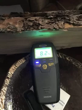

no eco bricks, the wood is very dry in my opinion, but have not used a meter.Do you have any ECO bricks you could put in to offset the wet wood?
