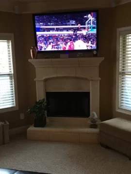

I hate this fireplace. (see picture)
The proportions seem all wrong. It's too tall! I'd like to lower the firebox and the mantel, put stone or brick around it and lower the TV also.
All suggestions are appreciated.

That looks like it might be a prefab, zero-clearance fireplace. If so it may be possible to replace the mantel with a lower one. Look in the door frame for an ID tag that lists the make and model. The manual will have clearance requirements.
It does say Zero clearance Floor and Top with a 9in mantel ht above. Side clearance says 14 inches. It's only 9 inches now.
So I guess the mantel can be as low as 9in above opening.
