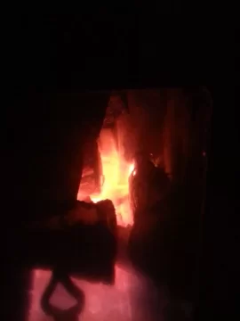

I have a Harman 300i insert, which uses the same secondary burn tubes and I have included a picture of that in action.
  • [Hearth.com] No burn time with my  Quadra Fire 5700
