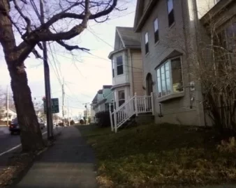

Didn't get a picture of the leafblower in action but this is my set-up. As you can see the my neighbor's house is really close and we are on a major road. The cars pile up in front of the house as there is a light at the intersection. I attempted to blow towards the ground to keep ash to a minimum but there was quite a cloud of ash in the road at the beginning. I'll have to pick slow traffic days to do this.
I figured people were driving by wandering what in the world I was doing.

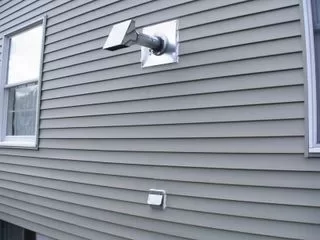

If my clean out T is inside and the end of the vent pipe is outside, can I make this work for my set up as well?
  • [Hearth.com] OFFICIAL: Post your leaf blower stove pipe cleaning pics.
Yep Syd, after you brush out the pipe and clean the stove as usual, put the cap back on the T, go outside w/ a step ladder, and hook to the pipe.
