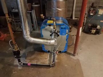

Some finished pics. Boiler installed. 3 new zone valves, new venting..all misc fittings replaced. Runs like a dream!!
Delivered to my door and install ran about $4,300. I pulled the old one out on my own.
How would you describe the noise level? That has always been my complaint with my oil boiler-sounds like a jet engine running up in my basement!
Looks great, you install it yourself?

I didn't have to mess with the nozzles at all because I bought the Riello kit direct from Supply House fpr the Buderus.
I had someone install it. The next time I have a job like this, I'll do it myself.
