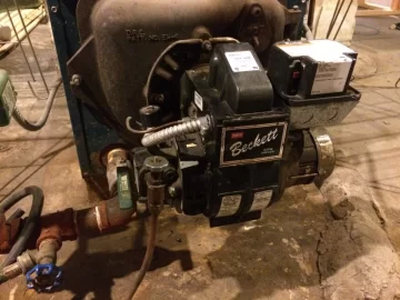

Here is a picture. I tried a new filter and gaskets earlier. It sounds stupid, but I have trouble seeing where the seeping starts, and there may be multiple leaks and ones I fix, etc. It flows down the filter, etc, etc. I might even have one on the underside of the filter outlet, but as I said, it's hard to tell. I might try a mirror to see better.
Here's a little trick for hard to find leaks...clean things up real good with some rubbing alcohol. Then spray possible leak areas with some spray deodorant, it will leave a dry powder film that shows leaks pretty well...bonus, it smells a lot better than fuel oil!

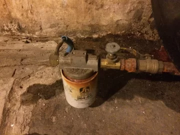

I'm not having any problems relating to starting but am preparing for an annual cleaning and service. I'm intentionally replying to this thread instead of starting another becuase I hoped the contributors in the thread would receive notifications via email. Would any of you mind sharing feedback on these questions?
1. Presently I have a simple setup with 1 spin-on type filter at the tank. Should I consider adding another filter in this order?
Tank > Shut off valve > Firomatic valve > Cartridge Filter > Spin-on filter
2. The big challenge here is the fuel line would need to be lengthened with a flare union. Presently it's sleeved and above the cement floor but buried under a concrete berm. If looking closely you'll also see a kink near the fitting. Should I cut and add 2 feet to the line and create a strain relief loop? (Didn't know if this is okay or against code)
FYI: The fluid on the floor is water, not oil. The bloaks who installed the sump and perimeter drain cut around the tank instead of following the wall. It was done before we bought the home.

That filter looks like it hasnt been replaced in years or got wet and rusted. Why mess with any of it or the fittings if its not leaking? Why not just put on a new spin on filter and be done? All it takes is a pinhole leak at a fitting to start pulling air into the line and the burner to lock out. A single 10 micron filter will pretty much stop anything from reaching the nozzle. They are easy and inexpensive to change. They are also 10 times less messy than those yarn filters to replace.
Mine is still there. Vacuum gauge still looks good. I'm sure the filter will be hard to remove, although I was the one who torqued it on so it might not be so bad. I'm paranoid about touching any of it-the stuff of nightmares.
