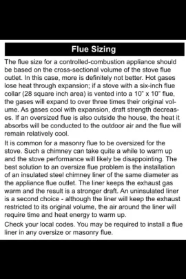

The manual advises if you have a 6" pipe venting into a say 10" flue the performance will be dissapointing. In other words it advises against a smaller pipe venting into a larger flue but doesn't say anything about a larger pipe venting into a smaller flue.........also thinking about it the pipe coming off the stove base is oval and then it goes into an 8" pipe. So essentially if I use a reducer it will go from an oval outlet off the stove (which is considerably smaller than a round 8" pipe) to an 8" pipe into a reducer to a 6" pipe then out the flue. Like I said the manual advises dont go small into large but doesnt mention going larger into smaller..

Hmm i didnt see that. This is odd. I am getting conflicting information now. This is all I found. (Below) Why would all these people recommend a reducer then and say its acceptable. I thank you for helping me [Hearth.com] Okay..Decided to pull the trigger on a new stove. Dutchwest 2462 (XL)

Page 5 it talks specifics for chimney size. The smaller models can be 6 inches, the larger 8 inches (which is the 2462). It is exactly the same with the encore/defiant (since dutchwest is monensen and therefore vc as well .... or was until a couple months ago). Encore = 6 or 8 inch, Defiant = 8 inch only.
You CAN run the stove with 6 inches (against recommendations). But if you follow this site at all you know what happens when people don't follow guidelines or try to push their stoves to do things that it isn't rate for....unhappy posters.
I would expect significant draft issues using this stove with a 6 inch reducer on a 6 inch liner. You may find smoke in the house a problem, or starting fires, or back puffing. All very common troubles discussed daily.
Either change the liner, or go with a smaller model/different stove.
