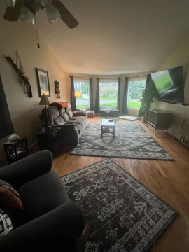

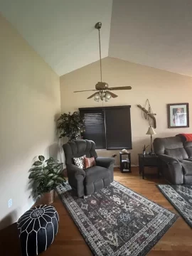

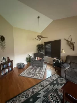

Coming out of lurking here in hopes to get feedback. The living room is about 14x24', the house is 1575 sq ft and ideally we just want a well working, non fussy, black looking stove for emergencies really. I did read that we should consider making up a template floor design with cardboard so we can really understand what a stove looks like and space between the wall, window.
If we needed it for emergencies, really we would just be ok with the living room heated but we could use a specific fan to direct the heat ( so I was told).
The lazyboy chair will be moved and the corner would be our choice. We would require the stove pipe up out of the ceiling vs the wall which I think is ok and standard? I have a budget of $4000.00 all in. Is this realistic? What do you think of a Timberwolf. Or any other ideas is welcome.
Thank you in advance.
PS: For some reason my living room photo came out long and distorted. Sorry:(

Is that a window behind the recliner? I would suggest the stove be placed where the end table is next to the couch. Wouldnt want the stove in front of the window. The Vaulted ceiling will trap a lot of heat. That ceiling fan may help. Placing a fan in the doorway to the living room blowing in may help with heat making it out to the rest of the house.
That install looks like it would be straight forward. Pipe going straight up through the ceiling.
