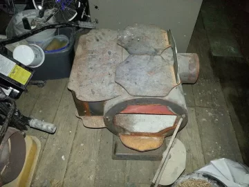

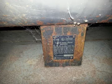

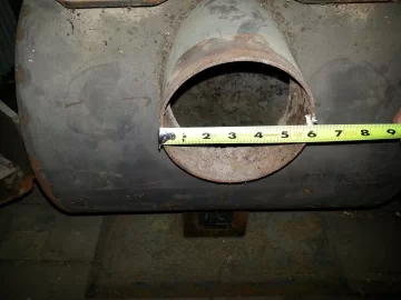

New to wood burning stoves/heaters. Someone gave me an Orley's heater and I would like to install it in my barn. Wondering if anyone has any experience with this heater and any installation tips would be helpful. Posted the images I have of the heater the Mfg tag says "F and FC Model heater warning date of mfg 11-80 Orley's Mfg co.,Inc Medford Oregon"

It's a barrel stove with a window. They were popular back in the early 80s, especially out west. It will munch through a lot of wood, but will put out the heat. These units commonly were installed on the hearth and rear-vented into the fireplace chimney. In a shop you will be under NFPA 211 rules. That requires 36" clearance in all directions unless there is proper wall shielding for a clearance reduction. The chimney installation requirements are the same as for a modern stove. The hearth needs to extend 8" beyond the stove footprint and 16" in front of the loading door. It should have about an R=.84 insulation value. If the floor is concrete then no need for a special hearth.

Thanks for the reply. Do you know what model it is? Trying to narrow down the model number to learn as much as I can before installing.
If it is a twenty inch firebox and holds 18" splits it is the Baby Jane MH-10742. Here is Orley Milligan's patent for the stove. Being made in Oregon they were one of the first ones whacked early by the Oregon emissions requirements.
