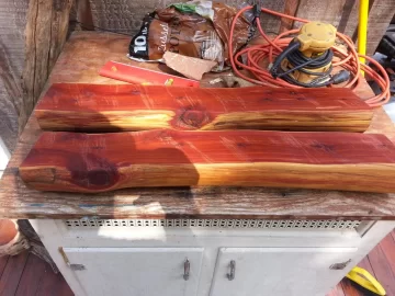

I've got a couple cedar logs that I cut to make into shelves in the corner above and behind my stove. Anybody got some advice as to how to mount these on the wall? Tia

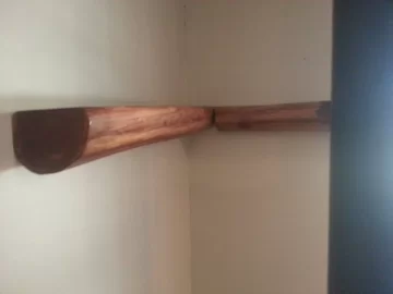

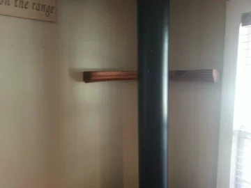

Well Its up. Still have to fill the holes with adhesive but it's pretty much done. I got some 8 inch lag bolts and drilled them in 4 inches and then cut the heads off and mounted the logs. Kinda tedious but it won't fall I don't believe.
[Hearth.com] ot: cedar log shelf
Reactions: NickDL and SKIN052
It looks nice to me. Now put some things on it.
LOVE the color on that flat milled surface
