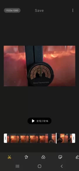

Height is around 23' with an offset. Dont know the exact readings he got. Not getting much heat output. Doesn't heat the house, or the room it's in for that matter. The picture shows temp gauge around 550. And that's as hot as it will get. I have dry wood.

I just but a full load in just a bit ago with that picture of temp gauge and the temp has already fallen to just under 500
