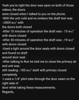

Just the blocking plate. So you can use either outside air or room air. And they are both blocked. Also I attached the report from draft test

Ok that isn't even 3x spec. That sounds like a reasonable measurement for your height and the fact that you have the intake restricted that much. The fact that he could fit a 1/4" tube through the doors anywhere when they were closed is a bit concerning though.
