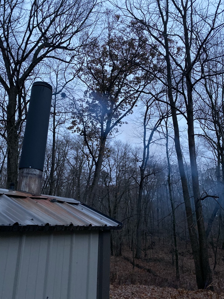

I feel like conventional OWB’s are despised on this site. That being said, I didn’t have $13-$20K for an install so I purchased a used conventional Heatmor. Bottom pic is at idle, middle pic is it just starting to cycle, third pic is approximately 5-7 min after the cycle starts. I wouldn’t necessarily say it’s smoking like a freight train. Actually seems like it generally smokes less than my Hitzer insert did. Now if I throw a full load of green wood in, then yes it smokes. As will any stove, and you wouldn’t want to throw green wood in a gasser.....indoor or outdoor. Now I also live in the middle of nowhere so neighbors aren’t really an issue. As far as the stench.....I kind of like the smell of a wood burning stove, call me crazy.

I came home to Ma from Me today and pass a few OWB. They were all smoking and I’m glad they are not near me.
Seeing a yard full of rounds tells me more than I need to know about what’s being burned.
mine will smoke like crazy with very dry wood worse than 20%-25% wood. It’s a balancing act to learn how to run it decent. My neighbors that are close enough to smell anything have all told me they love the smell from when I was burning inside. The MP is still cleaner than my original furnace in the basement.
I threw some green wood in a couple weeks ago and it smoked a lot during its first cycle
