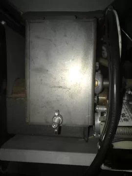

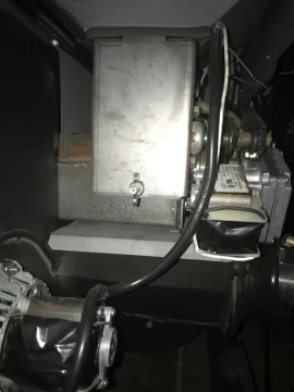

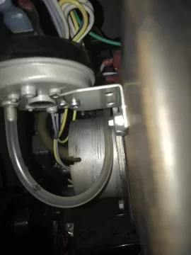

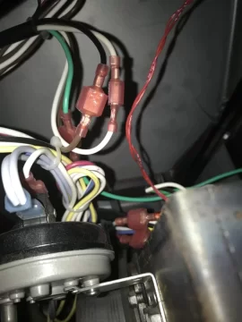

I’m in norton right off 495.glad you got things figured out. If I was closer I’d stop by to show you where the fines box is. But having said that if you open up the back of the stove look for a rectangular shaped box with a wing but on it. Open that up and vac everything out.
Some pics for you if the fines box and vac switch. Take some pics of the fines box when you open it up. If it’s jam packed then be sure to bring tvto you’re service guys attention. It should be part of the cleaning service

THANK YOU SO MUCH! It is really helpful! I will be able to locate it this time! I was trying to find it yesterday, but failed. I actually don't remember seeing the service guy open the back and clean in there! So are these pics from a P68 too? Your 3rd pic, what is the red thing? Do I need to do anything about it?

Those red wires go to your exhaust probe. It’s mounted with a quarter inch screw and needs to be pulled and cleaned up every year. I usually just wipe it down with a damp towel to get all the crud off it so it will read properly.

If your service guy didn’t get into the back of the stove, he didn’t fully clean it. That vacuum line needs pulled off the round grey and black vacuum switch and blown out as well.
Reactions: mqmtt
Yeah just follow the red wires to where the esp is mounted in the exhaust path. Back the screw out and pull up on the esp. that’s gotta be cleaned periodically. It’s the brains to the stove so if it gets gunked up it can cause the stove to do wacky things. As mentioned above disconnect the tube from the switch and blow into it towards the stove wall. Do not blow into the vac switch. Clean out the fines box and take a look at the blowers while you have the rear covers off. I’m betting that if the fines box isn’t being cleaned then neither are the fans. Give us some pics once you start digging
