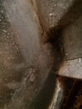

From what I saw in those pictures I wouldn't let those welds stop you from burning in it since they aren't outer firebox welds.

Very good to hear! I know when I find something that is broken I usually lose any sight of objectivity and want it fixed immediately so as hard as it is hang in there it sounds like they are planning on making it right.
Just looked at mine, one side is fine but the.other looks like the weld is stating to come out.

We've sold Hundreds of PE stoves since 2006. Literally truckloads. Never had a call on a cracked weld. Had a couple calls on "don't throw any heat/can't get it goin" (the wet wood guys), and 2 baffles replaced under wtty in 5 yrs of selling and servicing them. I heat my place w/ one since 2007, avg 4 cord a year. Thing is as solid as they day it was built. Steel stoves can get bad welds, or simply welds that fail.... much like a cast unit can develop a stress crack, or not have enough cement/gasket stuck in a seam somewhere. I've seen stoves of every type utterly fail, warp, crack, self destruct. It happens. PE should make good on it, and based on the pics, it aint a hard fix at all.
I have not inquired on having mine fixed yet. I must confess that I have been waiting to see how Hemlock resolves his ordeal. I have to wonder what would happen if nothing was done to the welds at all? I think mine are in the same location as Hemlock's. (I need to thoroughly check elsewhere though.) Maybe someone can answer that or speculate at least. I also wonder if having it welded will be long lasting, or will it be just as likely to crack again? There is also the hassle of having to disconnect the stove, hauling it somewhere without damaging it, finding a welder, hoping he knows what he's doing, hoping he can weld it properly, hoping he doesn't damage anything else and hoping I can get it back to the house and reinstalled without damaging it.
But then again, I paid quite a bit of money for the stove (at least to me I did), and the stove should not be having any issues for what little time I have owned it.
I'd call around now and locate a good, reputable welder that will come to your home. Get an estimate if you can so that you can refute a low-ball repair offer right away.

The frustration I experienced last year was because I noticed evidence of cracks in my repaired welds. I attempted to contact (via email and phone) the PE contact I dealt with my original warranty claim just to ask if the stove was safe to burn over the winter. To this day, I have not received any response or reply, despite leaving emails (with pictures of the cracks) and voice messages. When I called, they would always ask who was calling, and then state he wasn't in the office. I was hoping for better customer service.
I think the bigger issue is in regard to what is making the cracks in the first place and does it reduce the lifespan/safety of the stove? In Hogz and my situations, the outside steel of the firebox was cracking too. My stove it was just one spot on the door rim. Hogz was worse with the stove face on either side of the door cracking. Repairing the welds is fine, if the repair fixes the problem. However, if the repairs don't hold, what should be done? Also, depending on the usage of the stove, will the cracking stop at the internal weld or will they migrate to the exterior steel of the firebox? An exterior crack has the potential of causing over-firing, making a bad situation worse and dangerous.
These are questions that need to be asked and answered. If they cannot be answered, then repairing the weld is just a band-aid solution to a bigger problem.
