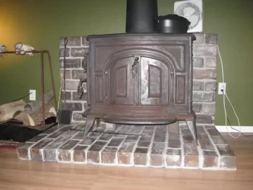

I recently bought a VC Vigilant off CL. It is in great shape with minor surface rust. Started cleaning it up last night with the intention of painting it with flat black high temp but after looking at the results of the wire wheel I don't want to paint it now. Is that a bad decision? My VC Resolute doesn't have any paint on it and the cast still looks great. A friend of mine with a VC puts a coat of paint on every spring to cover up any hot spots that effected the paint job... Don't want to make more work for myself by painting but want to make the stove last as long as I can. Thanks in advance for any advice.
Being cast iron, if you want you could use stove polish on it instead of paint. Hardware stores as well as stove shops carry it.
Or, if you really want to try and go for he gold, season it as if it were a cast iron frying pan. In my experience, I prefer using Original Crisco or Lard for the task.
pen
Im thinking polish would give it a nice lustre. Not to mention that if you season it with crisco or lard you will have to stop at least three times to eat something and ultimately it will take all day and youll gain three pounds.
I can see that! Hope it comes out well.
pen
Thanks for the input. I'm still wondering if it is bad to leave the cast completely untreated. I know it's not good for a cast iron pan unless you don't plan on cooking with it but what about this stove. Does it matter? It's not a basement stove. The room it sits in is dry and the basement underneath this room is dry. Will I still get rust in the summer when humidity is high if the stove goes untreated?
If it is left untreated it will rust. I seasoned mine with animal fat for a few days outside and it still looks great. I am not a fan of chemical's. good luck
10-4. Thanks.
I left mine un-painted/treated. If I was going to do anything I would treat with crisco like I do all my pans but as far as leaving untreated you certainly will not hurt it. The inside has no treatment other than a lot of heat so it it is that humid the stove is going to rust from the inside - out.
I just like the look after I hit it with the wire wheel. I will suggest if you plan to paint or treat with fat to do it outside and burn it real well with a short stove stack to get temps up high enough to set whatever you put on it well. If you do it indoors you will be dealing with a lot of burn off and stink.
Treating with crisco would look the nicest(compared to paint) IMO

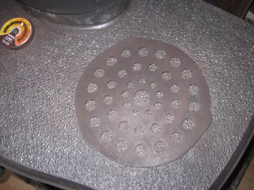

Here is a pick of the trivet I have on my stove to set my cast water pot on. It has been finished with one coat of olive oil. With two or three coats it would look, feel and perform like teflon. I did this to stop it from rusting if water spills or boils over. If you do it in doors the oil will stink but more like you are cooking. If you are patient and do not want to get it all lubed up at onece you can probably get it done with minimal repercusions in the house. Start on top because this will give you a better feel for how the crisco will react and save you the headache of it dripping all over. It will become hot liquid almost instantly depending on how much you flop on there. Think of it like a dollup of butter or back grease on the skillet you are going to cook pancakes on. It is exactly the same thing and actually both will work as well as crisco - just that crisco is a little cleaner typically. Iwouls start with a real small area to see how this will work "in house" and go from there. Don't worry about two toning as it will all even out - even if you do a little everyday over time. Get the stove hot and use gloves and an old cotton towel you do not care gets ruined. Dab it in the crisco and rub it on, smoothing and spreading out the liquid. It may take a couple coats to get the effect you want but let the fist soak in before adding more to the same area. Finished product will be hard shiny black and should last quite a while. The steel will actually soak it up and it becomes rather permanent although an over fire will burn some off just like paint.

Good looking trivet. Like the looks of the top of the Defiant even more! Too much stove for me. The vigilant will be a little much but the family is quite happy about the extra heat. I didn't paint, just wirebrushed the stove and plan on doing the olive oil/crisco. I tried a little Pam on the top of the stove just to see how it reacts. I'll try the olive oil next. I certainly could smell it but like you mentioned, it smells like I'm cooking. Not bad at all. Thanks for all the advice. Here's a pic of the new install.
  • Paint or no paint???
It cleaned up nicely and looks very nice.
Will you be enlarging the hearth? As it is, the hearth is seriously undersized, providing inadequate protection. In the manual, VC recommends 12" beyond the non-door, stove side and 18" of hearth in front of both the side and front loading doors.
Yes I do have to add to the hearth.

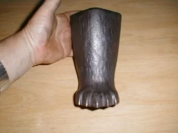

No matter what you use, when it's heated and "seasoned" it's difficult to impossible to go back to paint ! Stove black (polish) was made for cast, and has waxes and pigments to keep it black. The legs aren't going to get hot enough to darken and season the same as the hot surfaces. Extreme hot spots will burn off and not be consistant as well. Legs will stay sticky, and if you have animals, they will collect hair big time. (I had to due to cat hair) You can always wipe it off with the new inflamable mineral spirits warm, and stove black it cold. Once dry it polishes to a sheen. It's not as bad as the smell of curing paint and may need touch up from time to time, but lasts much longer than lard. It leaves the original cast iron texture visable and doesn't fill in intricate details like paint. Lard was normally for the cook top surface since it can be put on warm as it wears off the top. It was also for the machined surface that polish won't stick to.
Cookstoves were routinely shut down Sundays for "stove black day" and fired for the rest of the week. Monday was wash day and the railroad was required to run "clean stacks". Washing machines and paint put an end to this misery!
Here's polish on cast so it doen't fill in the surface detail; You can rub it down to look like almost bare cast, but it's protected.

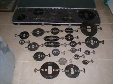

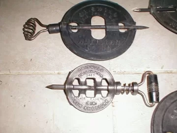

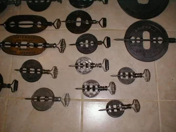

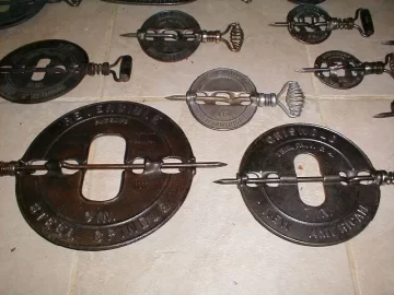

Here is varying amounts of stove polish to preserve a Griswold damper collection. I find it's best for the detail and shows if any are pitted from use. Most of these are new. I carry them to antique engine shows in rifle cases. You can see by dry polishing how shiny or dull you can control the finish on the picture of the dark 5 1/2" compared to 3 inch with wood handle. Far superior to seasoning them on the stove top. These have even seen rain and snow while on display. I keep WD-40 on the handle and polish the damper.

Wow, beautiful dampers. Polish looks great. So many opinions now I'm really confused(not a surprise). I better pour a cocktail and think about all this.

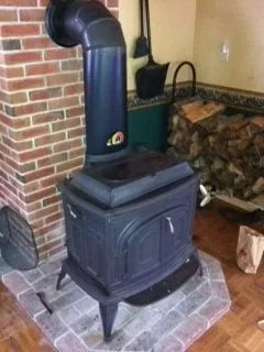

HH - stove looks great. I too suggest a larger footprint for your hearth for safety reasons. I offset my stove/heart to give more room on the loading door side for just that reason. I would weld the front door shut it if wasn't so convenient for cleaning. Never use it otherwise. My plan is to complete the hearth to the walls on both sides - about 4' and add some inside walls of brick to have the stove set in between them. I will also extend the center out another 10" or so on an arch after I decide on which stove I will be upgrading too. Any stove I get will be front loading and the side walls will provide safe, clean wood storage on both sides of the stove. I have access to an unlimited supply of those 100+ year old pavers.
Hope that all makes sense.
