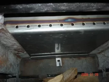

Update:
November 25, 2009 - I have my stove back finally!! The re-install started at around 8:30 am and they finished at 10:30 am. The dealership guys were top notch and did an excellent job. It wasn't easy and some Murphy's law occurred. But they took the time to do the job properly. They even replaced one ss. connector to make the connection easier.
I did inspect the firebox before it left the truck. It looks like all the welds were beefed up and hopefully they will hold tight. The only thing that I did notice was that the small crack in the steel rim was not repaired from the outside and is still visible on close inspection. It is covered by a weld on the inside, so it is sealed. I will keep an eye on it and hopefully the other re-welds will remove the stresses of expansion and contraction.
So I got the stove up and running and I am enjoying the wood heat as I am writing this! I will write up a final summary when I have more time and have a chance to reflect. I wish a great Thanksgiving to all of the American woodburners out there!!

Good to see it warming again. Got a new baffle too?

I did get a new baffle too! It was actually part of the original warranty claim I made back in early September, prior to discovering the cracked welds.

Cory also okayed a new baffle for me, but I told him & dealer I want to wait till this burning season is over, I can't go without one at this point.
Your baffle seems to have more holes on thr bottom that run front to back?
New added design? Maybe to help burn the stuff towards the rear of the firebox more evenly. I haven't had many problems in that area, but on a full load, when she is gassing off, it will pop or explode in the back there.
I am guessing cause all those gasses are accumulating back there with and then igniting at once.
