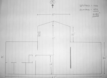

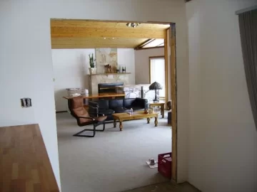

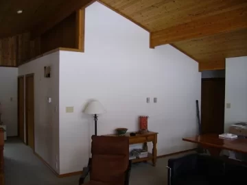

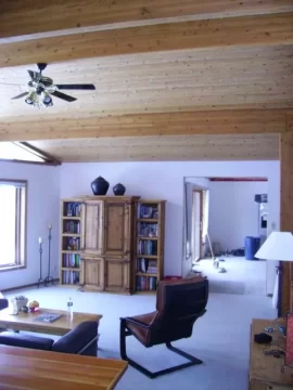

Need a stove. Wife wants (funny how that is the over riding factor) a cast iron PE. Don’t know which one to get. Background: House is 2 story with 6 out of 10 insulation. Huge north facing windows make room very cold. House is 690 square feet on mainfloor (my office plus spare room with a gas direct vent fireplace which is staying), and approximately 1490 upstairs. Only the center and right part of this really need heat as we sleep with the window open in our bedroom. Ceilings are 12’ in direct centre and slope down to 8’ for the rest of the house. Pic of a floorplan below. Basically 63x20 (30 at widest part). Cold living/tv room is approx 23x17.
Again see pics below. Woodstove would be where the X is.

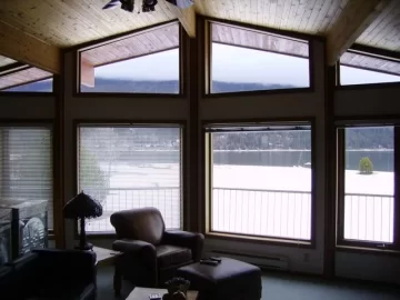

We live in the Kootenays outside of Nelson BC. Climate is similar to Spokane (we are four hours north). Tons of snow but rarely gets colder than -15C. Damp cold if you know what I mean. Most winter days are 0C to -8C.
Thought of putting stove on the main floor (basically the floorplan is just like the centre of the house. The two wings are two double car garages if you can picture that (yes all my buddies are jealous of my two separate double car garages). Was worried the heat wouldn’t make it up the stairway (basically the six o’clock of the plan which is not shown).

If you're just trying to impress us with pics of how beautiful your house is - you're doing a good job. That a friggin beautiful view of the water.
Trying to impress with how freaking cold that room is. All north facing windows, HVAC ducts in every room of the house except this one. This one has the cold air return ducts so there is a constant breeze. That is why there is electric heat by the windows there.

The room does have a lot of height and I am guessing (will check later this summer when I re-roof), R20 in the ceiling. No attic.
The existing gas burner in the pics makes a lot of noise and throws not too much heat. Takes a long time to warm up the room, and until that point the ceiling fan chills you out.

With that house & room setup & the water & climate, the low R-value in the roof, you will never fry yourself out of that room.
